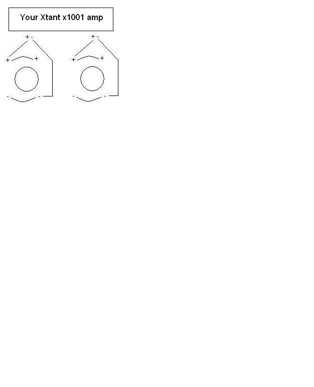

Wire each DVC sub in parallel and then to it's own set of terminals on the dual terminal outputs. Wiring each DVC in parallel will produce a 3ohm load for each sub. Then by wiring each sub to it's own set of dual terminal outputs will produce a 1.5 total ohm load at the amp.
BE CAREFUL. As Big Purds said, turn the gains all the way down at first. You will be sending just under 500watts to each sub if the gains are turned up! If you have the 12W6AE's then 500watts voids the warranty. If you have the 12W6V2's, then 500watts is approaching what JL calls the "Danger Zone". Just watch the gains and you should be okay running at 1.5ohms.
Here's what it should look like (it's a crude drawing, but I think it gets the point across!)...
