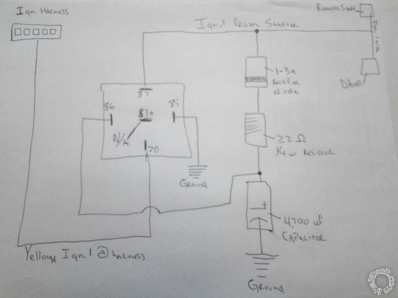

I've installed more remote starts than I can count, however, these newer GM cars such as Cobalt, Cruze, Equinox have become a problem.
I've heard that the ignition output needs to lag by about a 1/4 second behind the GWR or (-) while running wire for the vehicle to start.
The remote starters we install the GWR and ignition energize at exactly the same time.
For some reason these systems work great on the trucks like Sierra, Silverado but the cars have become a real issue.
The guys at Expresskit say we will need to build a time delay relay with a diode, resistor and capacitor on the ignition output to make it lag.
Is this true? Has anyone else ever ran into this issue?
Thank you for any input!

Posted: March 30, 2015 at 11:33 AM / IP Logged Link to Post Post Reply Quote digitalcustoms
new gm's with multiplex 2007+ -- posted image.
You need to slow down the signal in the Ign.1 wire so the acc circuit can power up first on units where the gwr comes on at the same time as acc and ign.

To hotwire a GM with multiplex, you take 2 12v+ wires hold one to acc, then put the other to ign1, and as soon as you power ign 1 drop voltage off at acc and the vehicles computer thinks the key is being turned and sends a crank signal. to remote start acc need to have voltage first, then ign.1 and cut voltage off at acc. the delay circuit posted above slows down the signal in ign.1 1/4 second to let acc fire up first.
