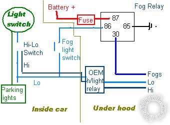

Joking aside, they would be for fogs and something else, it should only be 1 wire. Here's a simplified circuit.:- A97_fogs.bmp

It could use both wires...one as control for the relay as you've shown. The other for status of the relay output, as in are the fog lights on, i.e. an indicator on the switch.

Good point especially as you then have the (safer IMO) option of a ground going switch.
Although most Japanese stuff is wired as per my diagram plus illumination and grounding feeds at the switch.
