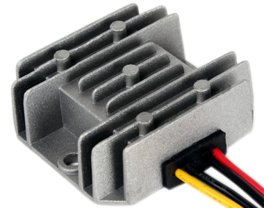

You might thus want to consider converters, and they'd normally be purchased complete. Current-Logic have several that might suit, and they are cheap - look at the lower "non-solated converter" section at current-logic dcdc_converter_all (search for "5V").
Just make sure any 12V input means "automotive 12V" - ie, operates with input voltages up to at least 16V, and below 12V - preferably own to 8V.
5V 10A converters as below are under $20.
PS - some dc-dc converters can be electrically noisy. Metal casing/shielding should prevent radiated noise. Capacitors across the output - usually around 0.01uF to 0.1uF - usually stop any conducted noise.

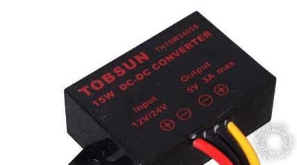

Im guessing,  that this one would be ideal,  specifically says car audio etc
DC-DC Power Converter reducer 12V/24V Step down to 5V 3A 15W f Car Audio LED TV
ebay Item number :  360613180623
for some reason links to this item cannot be copied and pasted
this seems to meet my needs, simple and effective,  the price just sux.

I like the looks of those Current-Logic alloy-cased units not only for their robustness, but more so because I reckon they should be well shielded (to prevent radiated noise). Price-wise I reckon they are cheap. I wouldn't hesitate to buy a spare (with any original order) even if it's never used (I'm a lover of redundancy - being able to replace or bypass faulty equipment anywhere and immediately).

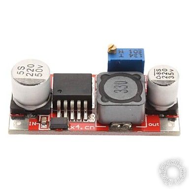

hello,
im going to move forward on these lil babys.  they seem to be a solution,  maybe not exactly,  but close enough for now,  I do like the ones above with the metal casings,  but couldnt find it under 20 bucks with shipping.  So,  I choose this one EUR 2.32 each free shipping anywhere in the world.  I got 3 for now,  if the work for me fine,  if not and i need to modify,   fine,  if that dont work I can attach it to a chain and hang it from my nipple ring; Im only out 6 - fity.
WTH? ..................... just kidding I would never hang anything from a nipple ring;  except my attention.
to shield or not to shield - Page 2 -- posted image.
Heres the specs:
Input voltage: 4-40V
Output Voltage: 1.5-35V (adjustable)
Output current: rated current 2A, maximum 3A (need to add heat sink),
if the output power greater than 15W, the proposed combined heat sink
Conversion efficiency: Up to 92% (output voltage higher, the higher the efficiency)
Switching Frequency: 150KHz
Rectifier: Non-Synchronous Rectification
Module Properties: Non-isolated step-down module (buck)
Short circuit protection: current limiting, since the recovery
Operating temperature: Industrial grade (-40 ℃ to +85 ℃) (output power 10W or less)
Full load temperature rise: 40 ℃
Load regulation: ± 0.5%
Voltage regulation: ± 0.5%
Dynamic response speed: 5% 200uS
Size: 43 (L) * 20 (W) * 14 (H) mm (with potentiometer)
Output ripple:
Input 12V Output 5V 3A 60mV (MAX)
Input 24V Output 12V 3A 120mV (MAX)

oldspark
Gold - Posts: 4,913
Joined: November 03, 2008
Posted: March 13, 2013 at 7:03 PM / IP Logged
Yeah, they certainly look impressive.
As long as people realise they are buck and don't lose their doe. (Puns, what puns?). IE, though the output is adjustable to 35V, they require the input voltage to exceed the output voltage.
That's irrelevant for you (ie, 12V in, 5V out is bucking fine), but as a caution to others (I think that Vin > Vout statement is on their page somewhere; it is not a buck-boost aka up or down converter.).
