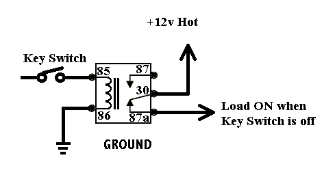

This, one 5 pin (87a) relay.

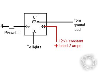

Noting that in Howard's break_a_circuit.bmp, the #30 & #87a can be in the light's +12V feed assuming the lights are switched with a +12V switch.
The +12V feed to #86 would also be taken from that switched +12V source. (Hence the relay is only activated when the lights are on.)
I can't find a suitable diagram in the12volt's Relay reference pages (surely one exists?!), but there is an equivalent by HotwaterWizard noting that its 86 will go to the +12V supply (eg. #30) and the pin (key switch) is to GND...
using a ground to break connection -- posted image.
FYI - the way it works is that 30 to 87a is NC (Normally Closed {connected}) when the relay is de-energised.
When the pin switch connects (tailgate open), the relay energises and switches 30 over to 87, hence breaking the "normal" feed to the lights.
