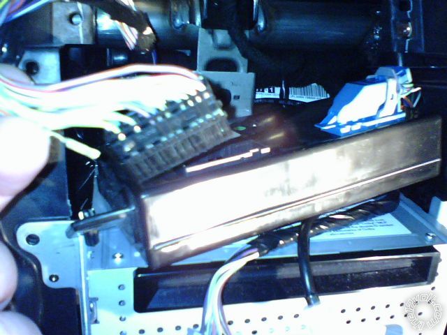

If your remote starter has a negative signal defroster wire, all you need to do is hook it into the cars defroster wire. You can use a diode if you like, but I don't think it is necessary. Here is a pic from a 2010 Fusion HVAC module where I tapped in. Depinned wire is defroster. 2010 fusion/milan defrost -- posted image.
modemjunki
Member - Posts: 18
Joined: December 16, 2010
Posted: April 07, 2013 at 1:16 PM / IP Logged
Thanks Monty.
My remote start has a single output channel - it can run the chip key emulator, or it can trigger the defrost (it has temp sensing) - but not both. :-(
It was a closeout and I suspect this was one of the reasons why.
Plus I want to trigger the seat heaters (pulse) and the defrost relay (latch) so additional circuitry is needed in any case. Using an Arduino means this will happen even if I don't use the remote start when it's below my preset temperature, sort of a convenience feature.
