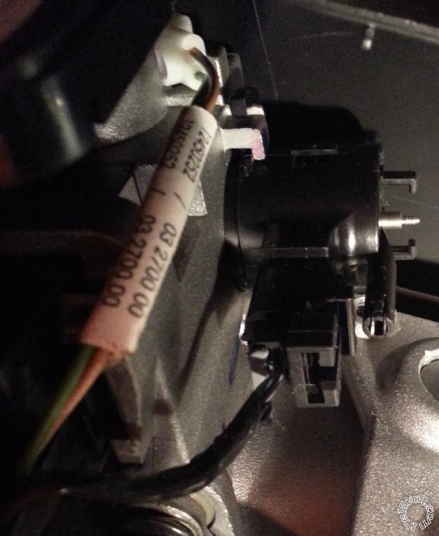

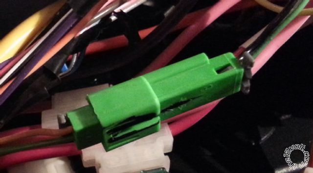

You should look in and around the key cylinder for the two plug you are wanting to connect the XK06 to.  Install instructions state that one is a black connector, the other is black or green. Take notice of the wire color indicated, (RED / White, Green,  White)

Ok, I just looked up there and there are 4 wires coming off of the key cylinder. One has a black connector at the the cylinder and contains a black and a blue wire. The other 2 wires connect to a green connector further down, and the wire colors are green and tan on one side and green and black on the other. However, I do not see any RED / white or white wires anywhere up there. Any additional ideas? Thanks for the reply!
