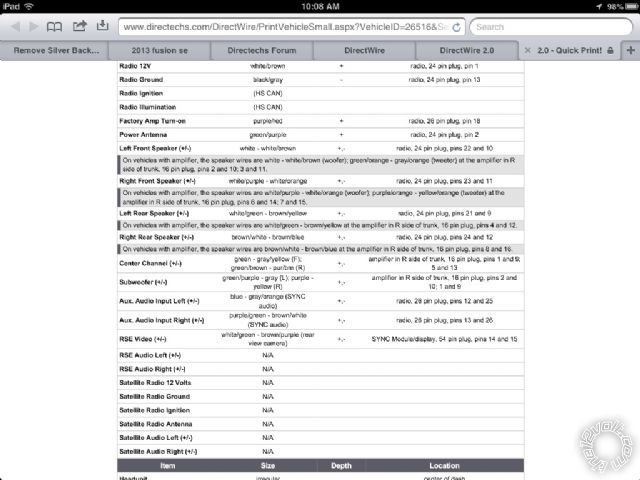

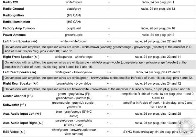

Hi I am going to be installing a sub in the trunk of my 2013 Fusion Se. The car has myford touch but doesn't have the Sony radio. I will be installing a Loc. I need a pin out of the connector that contains the speaker wires. TY

Here you go.

ty
