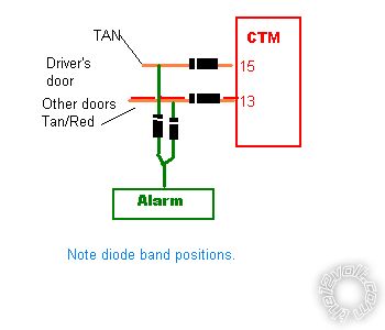

Mr. Idiot is far more knowledgeable than me on the theory side but my point is that 1N4001 diodes have a peak inverse of 50 volts, 1N4004, 400 volts and the back EMF generated when a relay shuts down is about 200 volts! Therefore......
As for the diodes, look at this:- durango_doors.bmp
For the above purpose, 1N4001 diodes are fine.

Though most recommend 1N4004 or 1N4007 as "the standard" 1N400x diodes, in this case where the diodes are in series (AND not to relay coils), the 1N4001 is fine.
(The 1N4004 & 7 have PIVs (peak inverse voltages) of 400V & 1000V respectively. They have tended to become the standard manufactured product - the other 1N400x's being dropped and often rarer or more expensive.)
oldspark wrote:
And in the correct circuit if you didn't install one for each.
Often when adding a circuit to door triggers, a diode is added to the new circuit so that it does not impact or trigger the existing circuit.
Likewise a diode is often inserted in the existing circuit to prevent that effecting the new circuit.
For grounding door switches, the line ends of the diodes are tied together and connected to the switch. Each "door trigger circuit" is then connected to the opposite ends of diodes.
