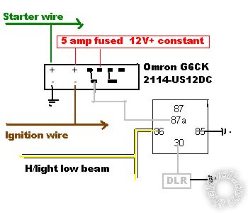

This is how you do it.
You use a latching relay that's triggered by the starter wire.
The ignition on shutdown goes to ground which will turn it off.
The second relay passes the voltage through to the DLRs but "disconnects" as soon as you turn on the low beam lights.
The Omron latching relay is readily available from Farnell or Mouser in North America. G6CK21124-US12DC.
It's a DPDT but you will only use one side as a SPDT.
Here's how:- dlr.bmp

Thanks you guy . I can find the constant 12v+ which is when I start the car also I can find the low beam wire.but I need you guy to show me the diagram how to connect it with the relay!what I need to connect is I need the CCFL light turn on when car start and turn off when the low beam turn off.

I've already given you the complete diagram but since you aren't listening why help?

Your starter wire is BLACK/ white, your ignition BLACK / YELLOW, as for your low beam, test.
