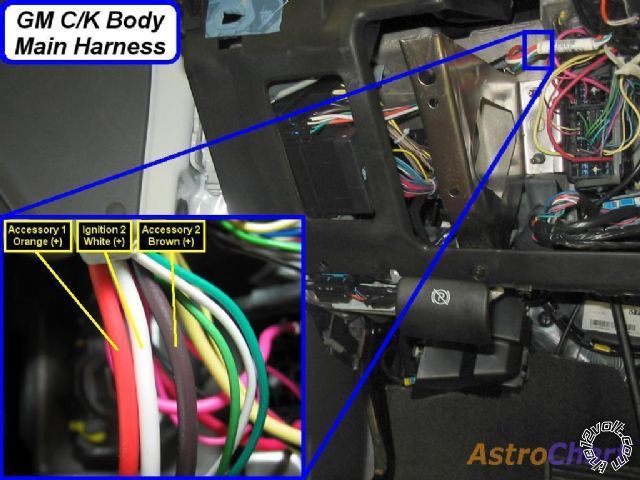

Also, I found that the second ignition was not white, in fact there was not a white wire in the whole bundle, it was actually orange and the accessory was actually the second yellow wire.

I don't believe that's an issue with the passlock bypass. That's usually caused by not having ALL tue accessories and or ignition wires powered up during remote start. Also can be caused by powering the accessories as ignition during remote start.   You should have two ignition wires. One pink and one white. You should also have two accessory wires. One orange and one brown. Believe me. They ARE there. Power The all properly and you will not have the service lights during remote start. r code for 2005 silverado remote start -- posted image.
