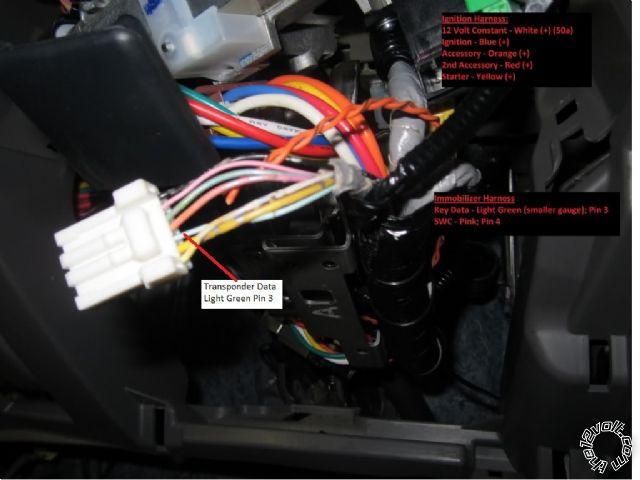

Think you have the wrong Light Green Data Wire. There should be a Yellow wire at Pin 2 right next to it that tests as an Ignition wire. It is a very pale Light Green wire that is very thin and somewhat fragile.
Platinum - Posts: 7,828
Posted: June 18, 2013 at 8:32 PM / IP Logged
Here is a photo of the transponder connector with the correct wire marked from the excellent 2007 Civic Pictorial posted by forum member Kenny.

i tried with that wire too. am i supose to plug the ignition harness back to the steering wheel? cause i unplugged all 5 wires (ign, starter, 12v, acc, on 1, on 2) for my remote and push start.
but even without those wires, i should be able to reset it, even thougg i never programmed it.
Posted: June 18, 2013 at 9:02 PM / IP Logged
Unplugged? Not sure if I understand correctly.
With a normal remote install, the thick ignition wires from the unit are just soldered on to the
correct vehicle ignition wires at the ignition harness. While your AdvancedKeys system is
slightly different in that a key is left in the ignition switch ( which is left in the ACC position ),
the vehicles main ignition harness should not be disassembled and should be still plugged
in to the ignition key cylinder like normal.
There is one gotcha with your vehicle. You have two Accessory wires and only one Ignition
wire and the AdvancedKeys unit is designed to handle two Ignition wires and only one Accessory
wire. This isn't a problem for a normal R/S system but with your system and the fact that the
key is left in the ACC position all the time...   Well, if Kenny is out there, I will let him explain the
ramifications.
