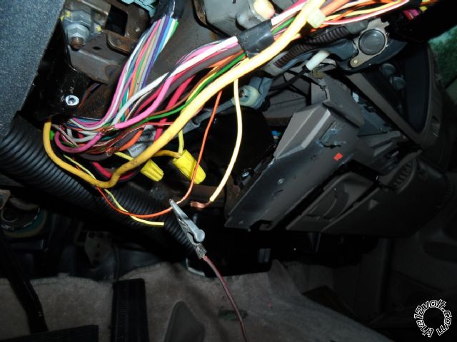

99 Suburban with faulty passlock2 system.
Bypass instructions say clip yellow wire, read resistance value between yellow keyside and ORANGE / black.
Problem is, resistance is showing 50 mega ohms.
So, I'm assuming the ignition passlock circuit is open.
Truck won't start, just fires and dies, security light on.
How do I figure out what resistance value the ECM needs?

current state:

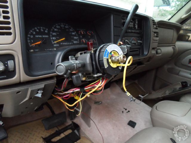

passlock2 bypass, cannot retrieve r value -- posted image.

I want to bypass completely.

the wire nuts are not me. I'm going to fix that with barrel crimps and moisture resistant heat shrink tubing.
