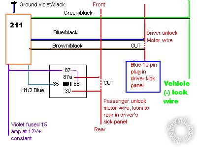

pts760
Copper - Posts: 403
Joined: December 11, 2009
Posted: July 04, 2013 at 6:21 PM / IP Logged
How is your progressive unlock wired up?
I drink current, eat ohms, and bleed voltage
Posted: July 04, 2013 at 6:47 PM / IP Logged
Parts needed 1 x standard automotive 5 pin relay.
1 x 1N4004 diode.
Note follow this diagram exactly what you join and the direction is very important.
Use the diode 1N4004 as shown.
Don't use WHITE/ black and TEST.

I have terminal 85 on relay tied to H1/2 which is (-)200 mA second unlock output. Terminal 86 on relay is tied to constant 12v power. I cut the red wire for the driver unlock motor and tied the side which goes into the door to the motor to terminal 30 on the relay. The side of the red wire going back to the plug I tied to terminal 87A. Terminal 87 on the relay is tied to constant 12v.
Posted: July 04, 2013 at 7:00 PM / IP Logged
Your wiring is correct but you need it for the PASSENGER UNLOCK MOTOR WIRE.
Not the driver's you need the 211 internal relay to unlockthe driver's first.
All explained in the picture and don't forget the diode, it's mandatory otherwise you will fry the 211.

Howie II, your diagram seems to make more sense than the directions I was given . I questioned them but was assured it would work. I do have a question though. What is the reason for installing a diode across the relay coil?
