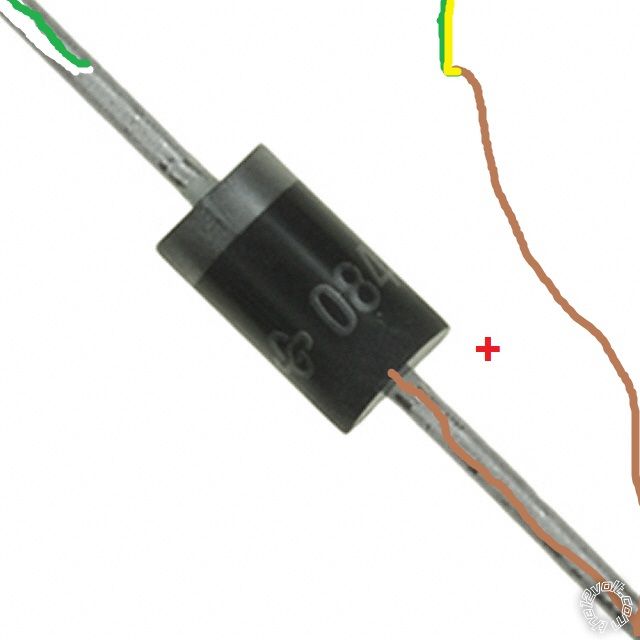

And I need to connect one wire (brown +) to 4 signal, Anyone know which wire is supposed connect to?
turn signal lights wiring -- posted image.

Steering column loom, 2 wires one will flash on left indicator, other on right split that brown wire via 2 x 1N5404 diodes, bands towards wires.

Posted: July 10, 2013 at 1:46 PM / IP Logged
Possible to put only one diode in one wire (after the split)?
Posted: July 10, 2013 at 1:53 PM / IP Logged
Not thinking this through are we.....
If you diode the left only, when you drive and indicate right BOTH SIDESwill work, put it on the right only, indicate left, again etc.
