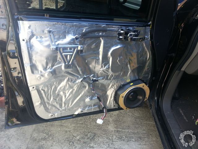

those sound like nice systems either way you go. definitely leave room in your budget for some type of sound dampening for your doors, it will make a difference in how the speakers sound as well as seal up the door and usually results in a little better bass response from your mids.
if i recall your ram has 6x9's in the front doors so you will need some sort of adapter to seal the 6x9 hole and convert it to a 6.5. its usually better to make the adapters yourself out of 1/4" wood because the plastic adapters arent very good and they only let you place the mid in a certain spot, which doesnt always work depending on the size of your mids. making them yourself will let you center the mid in the 6x9 hole or offset the mid to avoid hitting anything in the door.
like some opinions on setup ideas -- posted image.
something like what you see in the picture of my door. those are 7" mids so i had no choice but to make my own adapters.
i would also run new speaker wire into your doors from the amp so you dont have to worry about using the factory speaker wires of bypassing the factory amp if you have the premium system.

oh man thanks. what did make your adapter out of? glad to get more pics of process and finished setup if u got some.
