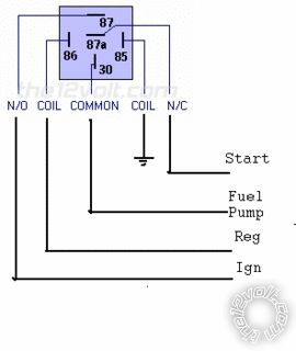

The simplest fuel pump relay is one controlled by the alternator charge light.
Primimg can be via the starter circuit - either by using an SPDT relay or by combining alternator and starter signals thru diodes to the relay coil. EG...
(with thanks to Tezza; & "Reg" is the alternator's/regulator's D+ or L or dash "charge light" terminal/circuit)
Fuel Pump, 1970 Fiat Spider -- posted image.
FYI - the above method is often used for fuel cutoffs, electric chokes and - without the prime - for battery isolators, DRLs, etc.
