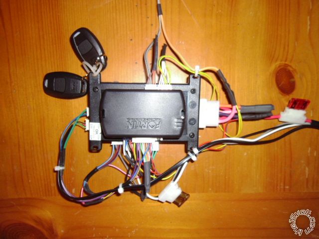

Below is an Avital R/S system with the Fortin EVO-ALL bypass module connected in the W2W mode, bench prepped and ready
for vehicle install.
viper 5904 with xpresskit db all -- posted image.

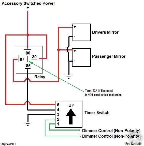

One last question, for now, I am also going to install heated mirrors in my Tacoma using a switch and mirrors from a 2012 Highlander. This is all separate from any of the truck computers. So, on the viper system there is a defroster option I believe , and that is what I will use to turn on the heated mirrors utilizing the switch which I believe has the timer built in to control a separate higher amp relay. So, I guess my question is; the wire from the viper to operate defrost(for any car) is that wire to make ground or supply + ? I should be able to look at a wire diagram for 2012 highlander and see where it goes I think, right? Thanks again, and sorry for asking so many questions.

The Viper does have a defrost control output. It is H2/3 Blue/White wire. This wire supplies a (-) 200mA signal. It can be
programmed using Menu 3, Item 11 for either a latched output or a single .8 second pulse output. Not sure where you
plan to connect this wire ( vehicle or heated side view mirror switch ).

Got the 2013 Hyundai Sonata install completed (viper 5904 with expresskit DB-All). Only issue was the dreaded "toggle switch off" message, I just joined the 2 wires and eliminated the switch and then grounded one of those wires. Next up will be the 2013 Toyota Tacoma install using Viper 5904 and Idatalink transponder bypass. I think that I will use the Viper's 3 pin harness (door lock port) and connect those wires to the truck's factory arm/disarm wires and not use the Viper's arm/disarm wires nor the lock/unlock wires on the truck. I read that in another post. Does anyone know if there is any "special" programming needed to be done to the Viper? I have a bitwriter. Also, any suggestions for 12V sources other then the ignition switch? I am also installing heated mirrors and would like to use the Viper's H2/2 blue/white wire rear defogger output to turn the heater mirror's on as if they were a defroster. Here is the diagram for the mirror's. viper 5904 with xpresskit db all -- posted image.
The five connections are...
1: Illumination Constant
2: Illumination Rheostat
3: Ground
4: Timed Ground
5: Accessory positive
Any suggestions as to where to connect the Viper blue/white wire? It would have to trigger a ground for the timer portion of the switch. Thanks!!
