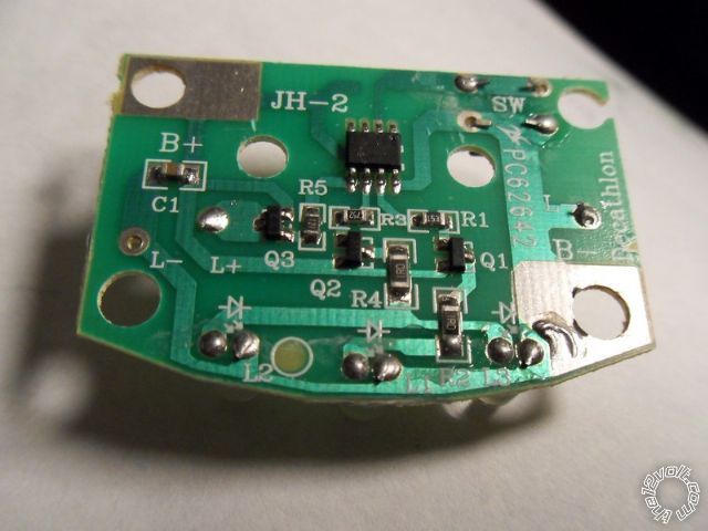

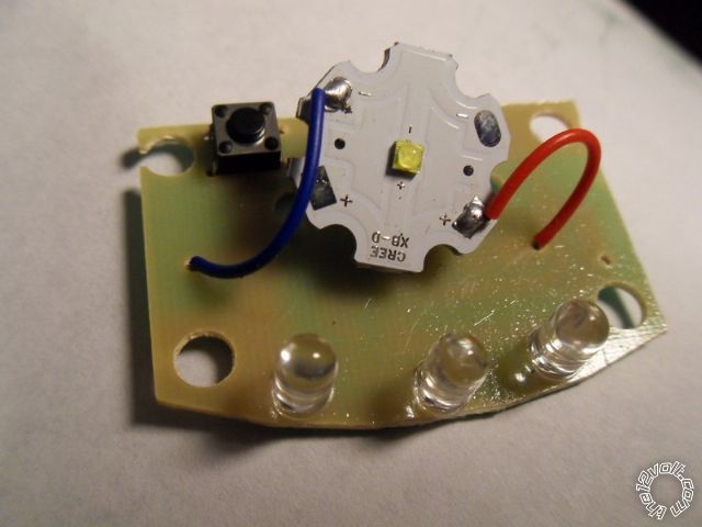

Another off-the-shelf option is this headlamp recently purchased from Home Depot, package of two for 9.95. It incorporates a surprisingly bright, easily adequate for my needs, Cree XB-D element with three aux leds together running on three 1.5v alkaline aaa cells, 4.5vdc fitting the needs of this project quite well
Pics of the innards...
antique cycle 6v adding led headlamp -- posted image.
I hope I can get some advice here.   I'd really like to get this put together in some way that I can get max brightness out of this antiquated 4vac ~ 16vac magneto.

There are 2 distinct aspects to a project like this, namely:
- powering of the LED(s)
- charging of the batteries.
As I recall, the original proposed light was a self contained LED with LiPo battery with a DC input (to charge the LiPos).
In that case the dc-dc converter merely supplies the correct DC voltage and the light unit looks after the LED and battery charging.
LiPos as with any Lithium battery requires a specific charging method else explosion or fire can result, hence you want to avoid that.
Other battery types have their own charging methods.
And the battery charging voltage will be different to what the LED(s) require, so 2 distinct voltage sources are required (unless you use whatever method the "light" uses to control that).
Combined with the hassle needed to mount LEDs and lens them, buying a ready made unit seems a sensible way to go.

svejk wrote:
I don't want to be constantly removing, recharging, batteries as the light output gets dimmer and dimmer.
You won't. The dc-dc converter plugs into the light's external DC power socket.
