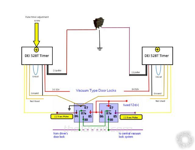

I have the vacuum operated locks on my 126 S-Class Mercedes and want to add an internal switch to lock and unlock from inside, there is a diagram in general for this but as a novice I do not know how to incorporate a timer as mine needs 3 seconds I believe could someone assist with this please.

What type of switch(s) are you looking for in the Mercedes? A momentary switch for lock and a momentary switch for unlock (two separate switches) or one momentary switch that locks and unlocks the door? How many switches?

I would like to operate it from one switch if possible Thank you

This is what you are going to need:
-(2) 30/40A SPDT Relays
-(1) On-Off-On Mometary Rocker Switch
-(2) DEI 528T Timers...(Here's a link for the DEI 528T)
-fuses, solder, electric tapes, shrink wrap, etc., etc.
