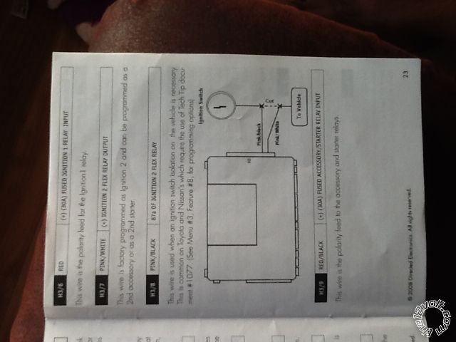

Looks like all I'm missing is the second starter wire, can I use the pink / white wire (H3/7) to connect to the starter side of the car? What wire to connect to the key side?
Attached is the page from the installation book.
Thank you for the help.2008 toyota highlander -- posted image.

Assuming non-PTS Highlander.
H3/1 PINK (+) IGNITION 1 INPUT/OUTPUT        Black @ ignition switch
H3/2 RED / WHITE (+) FUSED (30A) IGNITION 2 WHITE/ Black @ ignition switch
H3/3 ORANGE (+) ACCESSORY OUTPUT Gray @ ignition switch
H3/4 VIOLET (+) STARTER OUTPUT (CAR SIDE)Yellow @ ignition switch     cut wire
H3/5 GREEN (+) STARTER INPUT (KEY SIDE)     Yellow @ ignition switch     cut wire
H3/6 RED (+) FUSED (30A) IGNITION 1 INPUT   WHITE/ Black @ ignition switch
H3/7 PINK/WHITE (+) IGNITION 2 / FLEX RELAY OUTPUT Light Blue @ ignition switch
H3/8 PINK/BLACK (+) FLEX RELAY INPUT 87A not used
H3/9 RED / BLACK (+) FUSED (30A) ACC/STARTER INPUT  WHITE/ Black @ ignition switch
H3/10 NC (no connection)
Extra 30/40 Amp SPDT relay for Starter2
Relay Pin 85 to Viper H2/13 Purple (-) 200mA STARTER OUTPUT
Relay Pin 86 and 87 to Highlander WHITE/ Black @ ignition switch thru 20 Amp fuse
Relay Pin 30 to Highlander Red @ ignition switch
Relay Pin 87a not used - insulate

Kreg357,
Thank you once again, one more question, the red wire at the ignition switch (starter 2) needs not to be cut, right? The pin 30 wire just needs to tapped into the red starter 2?
I will be getting the pkall for the transponder bypass and once I make these connections I should be good to go, thanks to you.
2010 Tundra
Platinum - Posts: 7,828
Posted: September 08, 2013 at 7:16 PM / IP Logged
Correct, no need to cut Starter2, just tap on the Relay Pin 30 output wire. Verify that the truck won't crank the starter & start with the key when the Viper alarm is set.
