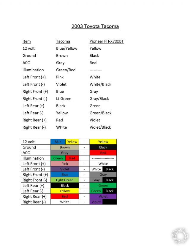

Hi All,
I've taken a lot of useful information from this great site so I thought I'd give back something I made while upgrading the radio in my 2003 Tacoma. The vehicle side could be helpful even if installing a different radio.
2003 Toyota Tacoma Stereo Wiring -- posted image.
Platinum - Posts: 13,728
Posted: September 09, 2013 at 3:26 PM / IP Logged
Or you could drop the 15 dollars on a Metra 70-1761 and not have to cut any wires and be through in less than half the time.
