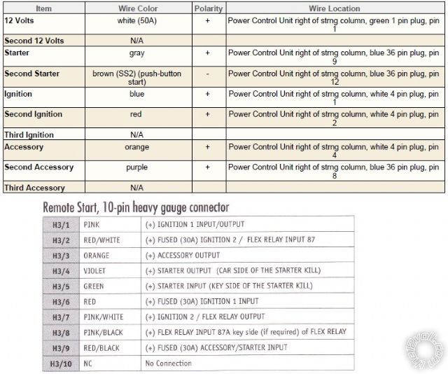

Hey guys, its been a real long time since I did a remote start install and just need a little help since I am pretty rusty. I have also never done a vehicle with push button start. Can you guys tell me if I got this right?
RDX wires are on the left. 5704 wires are on the right
2013 rdx w/ push button vs viper 5704 -- posted image.
12 volts = white      -----      red and RED / white
second 12 volts = NA     -----      NA
starter = gray -----      violet car side and green key side
second starter = brown     -----     NA
ignition = blue -----     pink
second ignition = red     -----     pink/white
third ignition = NA     -----     NA
accessory = orange     -----     orange
second accessory = purple ---     RED / black
third accessory = NA     -----     NA
pink/black of 5704 is not used

It would probably be a good idea to use a flash module that handles everything through data for remote starting and keyless entry ,and alarm but I don't think secure takeover is available on this vehicle . Idatalink CA maybe ? The install looks pretty straightforward .

yea I am going to use a flash module but was just getting the H3 harness out of the way

The Red ,RED / Black and RED / White wires are 12v input and needs to be connected to a 12v source like the White wire from the power control unit. The second accessory wire in the car (Purple) while it may not be necessary to be connected but if you have to on the H2 harness on the 5704 (H2/22) it's an Orange wire (-) 200 mA accessory output , you can use this with a relay to power the second accessory wire.

Car will die when you open the door. Just did one last week. Use a ADS AL CA
