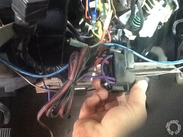

Here is the relay connected to the ign harness:

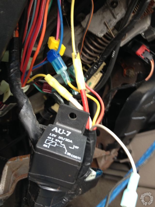

Also, I found 2 relays connected together for the door lock/unlock function. :

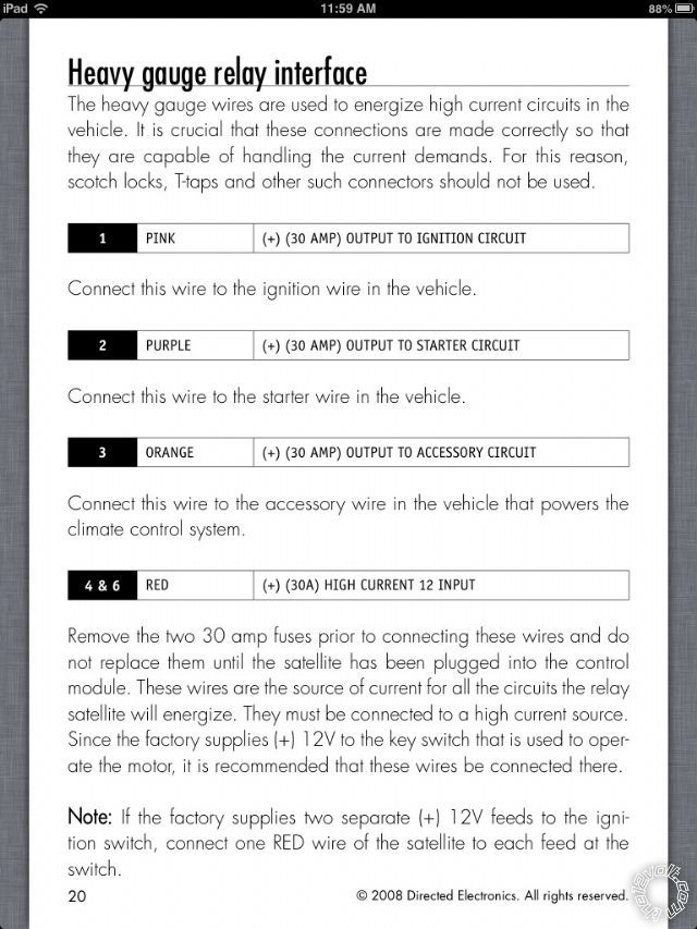

Now, to the heart of the matter: will I need to use the relay when connecting the Heavy Gauge wiring harness to the Avital 4103 for the remote start option?
Here is the wiring description for the Heavy Gauge wires:
2003 dodge ram 1500, avital 4103xl -- posted image.

I'm looking for help in getting the Heavy guage wires figured out on the remote start. Am I going to have to cut some wires, add in a relay, or do I just connect the wires to their respective places on the ign switch harness and solder them in? The BLUE and the YELLOW wires in the ign switch harness are kinda small gauge....am I supposed t hook up the PURPLE (30a) starter wire to that small yellow wire?
And also...should I keep that double relay and use it for the door locks? It has the resistors already crimped on the ends of the wire going to the LOCK/UNLOCK wire harness in the truck.

While I'm not a fan of crimped wire connections, I would re-use the current door lock relays. That will
save you some time & money. If you get a chance to switch the connections over to soldered, so much
the better.

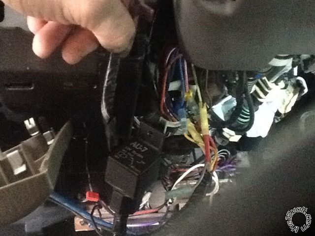

The photo of the ignition relay doesn't show the actual wire that was cut or tapped into.   I'm guessing
that is was for a Starter Kill circuit when the old alarm system was armed. Anyway, your truck has more
ignition wires than the Avital 4103 has (+) 30 Amp outputs. Here is the wiring necessary :
Avital 4103       2003 Ram 150
1 PINK (+) (30 AMP) OUTPUT IGNITION        BLUE (+) 16 Ga @ IGNITION SWITCH HARNESS
2 PURPLE (+) (30 AMP) OUTPUT TO STARTER YELLOW (+) @ IGNITION SWITCH HARNESS
3 ORANGE (+) (30 AMP) OUTPUT TO ACCESSORY    GREEN (+)   @ IGNITION SWITCH HARNESS
4 RED (+) (30A) HIGH CURRENT 12 INPUT     PINK/BLACK (+) @ IGNITION SWITCH HARNESS
5 PINK/WHITE (+) PROGRAMMABLE OUTPUT FOR ACC2 OR IGN2      RED / WHITE (+) 16 Ga @ IGNITION SWITCH HARNESS **4103 set to IGN2
6 RED (+) (30A) HIGH CURRENT 12V INPUT PINK/BLACK (+) @ IGNITION SWITCH HARNESS
That leaves the Accessory 2 wire. Use a 30/40 Amp SPDT relay and wire as follows :
Relay Pin85 to 4103 ORANGE (-) ACCESSORY OUTPUT wire @ 4 Pin Satellite harness
Relay Pin 86 and 87 to PINK/BLACK (+) @ IGNITION SWITCH HARNESS fuse at 20A ***
Relay Pin 30 to ORANGE (+) @ IGNITION SWITCH HARNESS
Relay Pin 87a not used - insulate
You could use the RED / White +12V constant wire but use a DMM to verify this wire as per the note below.
Notes from Bulldog Security :
Use the BLUE 16 Gauge wire as IGNITION #1, DO NOT use the HEAVY GAUGE BLUE
wire for IGNITION #1. The Ignition #2 wire, RED / WHITE, is also 16 Gauge, there will be
(2) RED / WHITE wires of the same gauge in the Ignition Switch Harness, one wire will
test 12 Volts constant all the time and the other will test as Ignition #2, only use the
wires that tests like an Ignition wire.
Accessory1 wire is the large Green wire. Accessory2 is a 16 Gauge Orange wire.

Kreg....once again, you come thru for me. Who says chivalry is dead? The pictures I took were taken with my ipad 2, which has a doodiety camera on it. Here is a good pic of the relay that's left over from my old crap-ass security system.
You can see that the YELLOW wire was cut. Will I need to reconnect that wire to make it 1 wire again?

Thanks for the better photo. Yes, it looks like they cut the Yellow Starter wire. You could keep that Starter Kill relay and use H1/5 Orange wire and Menu 2, Item 9 to control it. Or you could cut out the relay, reconnect the Yellow Starter wire and connect as listed above.
