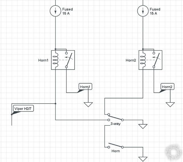

I found this handy online circuitlab deal, and tried to create what I want to do. Here's the diagram that I made where Horn2 is the factory horn/relay combo and Horn1 is my add-on.
I think I have the toggle switch done right and hopefully I can just flip between being able to use Horn1 and Horn2 (using the steering wheel horn to activate). The H2/7 wire is going to the Aux 1 wire on my Viper 5704 unit.
Any issues with this?

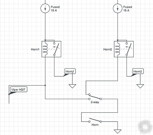

*Correction...wrong image in the first one. Sorry.
horns toggled and via viper aux channel -- posted image.

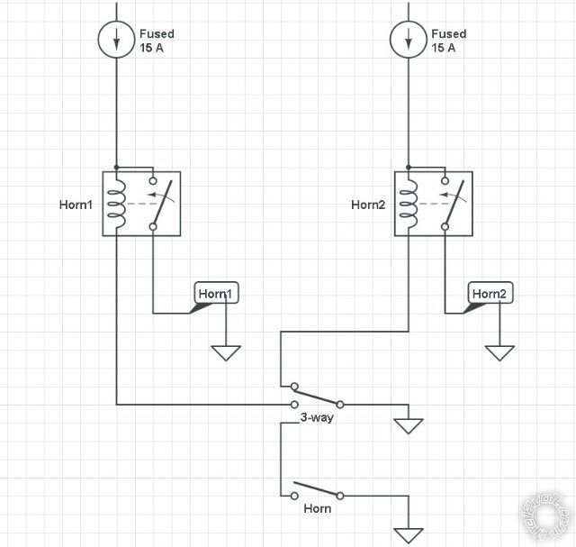

Damn. Final redo. I started to look at this and noticed a couple issues. Besides, no need for a 3-way switch when I just need one or the other.
