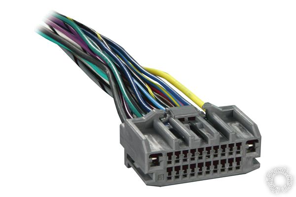

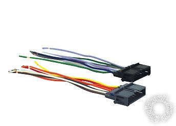

head unit swap 2002 dodge grand caravan -- posted image.head unit swap 2002 dodge grand caravan -- posted image.
Here are the two connectors. I'm thinking that because they're from the same year and model that the wiring will have the same colors just pinned to different connectors.

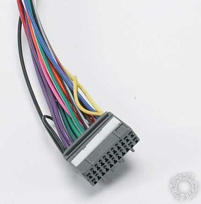

Oops! This is the single connector.
soundnsecurity
Gold - Posts: 2,720
Joined: November 10, 2008
Posted: November 04, 2013 at 6:14 AM / IP Logged
the two factory units are not compatible with each other. the newer radio uses a data signal from the car to turn on instead of just an accessory power wire like the old radios. in short, you will never get the new radio to turn on if you swap it into an older model car.
