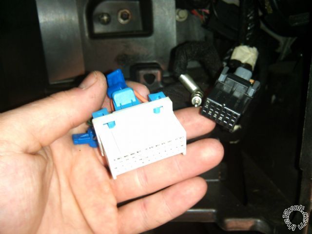

Ok guys one last question please. I did purchase the correct wire harness however where the factory harness hooks up to the stock radio there are two plugs one larger familiar looking plug and the other is about half the size. The wire harness I have looks like it only utilizes the larger stock plug. I'm assuming that the box hooked up to this fancy wire harness I had to buy eliminates the need for the secondary smaller factory plug.
Can I just wire up the adaptor and leave that smaller oem plug alone since im using the correct harness?

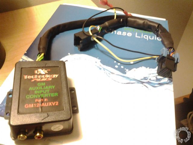

Posted: November 17, 2013 at 1:43 AM / IP Logged
This is also something I have yet to run into. Looks like a factory aux input probably a several hundo add at the time.
