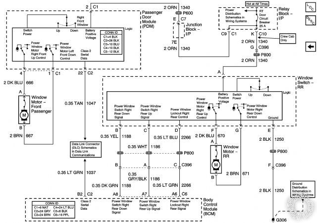

Two 529Ts were brought to me (10 wire version). So the 530 is not an option.
The goal is to have one 529T on each front door. Windows roll up with Viper arm. Windows roll down with AUX channel.
Mainly, I suppose I need to know which type of setup the 04 Silverado has. Type A, Type B, etc. I trusted another installer on wiring this up, but it doesn't work and now the motor wires are cut and soldered in place, so undoing it to meter the factory setup would be a pain in the neck. If I remember right, we have it as follows:
529T blue wire went to motor side up wire
Brown went to switch side of up wire
Green went to motor side of down wire
White went to switch side of down wire
Red went to +12V constant
Black to ground
Orange went to Ground When Armed from Viper (to trigger motor up wires)
ORANGE / Black went to RED / White AUX channel from Viper (to trigger motor down wires)
But this did not work at all. OEM switches don't even work anymore. I suspect we have a different type of setup on the Silverado. Polarity switching or something....

im not sure how many door/windows your truck has that are pomer but here are some 2004 GM C/K schematics.
looks like your truck windows are controlled by body control modules.
i hope someone chimes in with some good advice.
