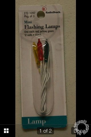

Back in the day we used to buy these lights from Radio Shack, put them in the marker lights or headlights and just turn them on while parked just because. They randomly flash as they warm up and created a flickering/dancing effect.
So I wanted to get them now (20 years later) and use them, just because nobody else does, They are discontinued at Radio Shack and I cannot find them anywhere. I know they have flashing LED's which will work, but what would be the easiest way to make them randomly flash so they are not all just blinking on and off at the same time? Like a list of parts and schematic possibly?
dancing lights -- posted image.

Give this a shot, I have done it with similar devices:
+12 to LED, LED to one of those Bulbs, Bulb to ground.
Basically, you are using one of those bulbs as your ground path, and once it heats up, will remove ground each time it blinks off.

Cant do that, I have NONE of these bulbs available
