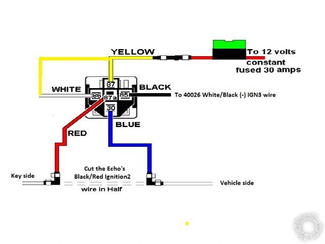

That TechTip #1077 diagram is "generic".  Depending on the vehicle needs, you might have to use a relay to isolate an
Ignition wire or an Accessory wire.  With the Echo, it's the IGN2 wire.  Here is the exact relay wiring for your exact car,
using the 40026 remote starter system :
Relay Pin 85 to 40026 WHITE/ Black (-) IGN3 wire
Relay Pin 86 and 87 to +12V constant thru fuse
Relay Pin 87A to ignition switch side of cut Echo BLACK/ Red IGN2 wire
Relay Pin 30 to vehicle side of cut Echo BLACK/ Red IGN2 wire
The 40026's thick Green IGN2 wire would not used.
Platinum - Posts: 7,827
Posted: December 14, 2013 at 4:27 AM / IP Logged
Here is a diagram ( the relays actual harness wire colors might be different on your relay )
2001 echo remote start ign2 confusion -- posted image.

THANKS! for the info. Unfortunately :( my unit does not have an IGN3 on it. So looks like it wont work. I ordered an Avital 4113L but looking at the diagram, not sure if it will work either. Because I'm not sure what that IGN2 actually does when the unit tries to start the car. I suppose I need now to look at the Echo wiring diagram and learn what IGN2 is all about.
