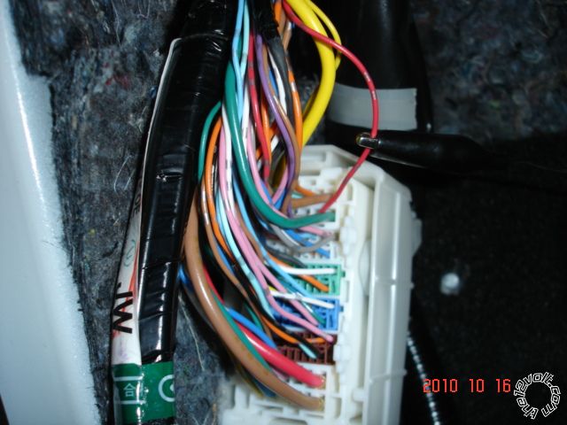

I'm trying to figure out which red wire down at the driver's side kick panel would be for flashing the lights? I've tried all 3 in that area and none seem to work?
Also. which wire would I have to tie into for the rear defroster? Thank you.

Platinum - Posts: 7,828
Posted: December 26, 2013 at 8:37 PM / IP Logged
Here is a photo of the (+) Parking Light wire in the DKP :
2009 remote start issues -- posted image.
Here is the Rear Defroster wire info from Audiovox :
   Rear Defrost        LIGHT BLUE  (-)        AT A/C CONTROL UNIT  (  ALSO AT BCM MODULE BEHIND GLOVEBOX  )
