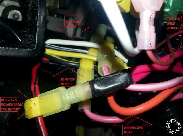

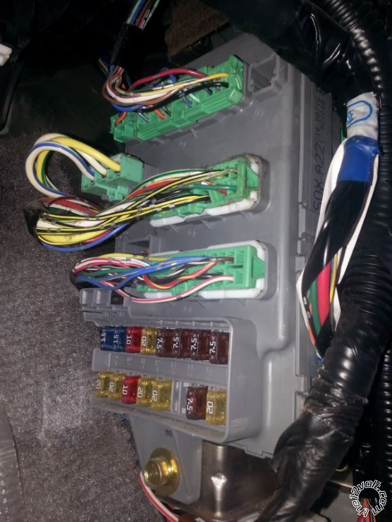

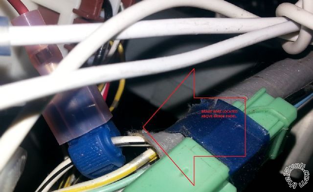

Problem: Everytime I remote start the van alarm went off. The car has no problem with starting with the remote and bypass works just fine.
System installed: Python 4113 Single button + XK05.
Thank you in advance.

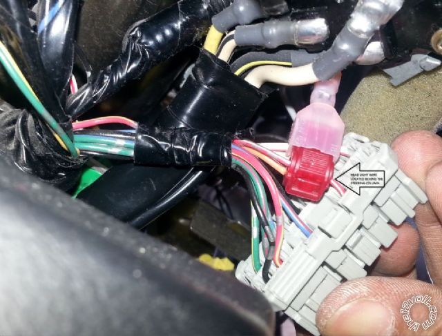

Brake:
Headlight:

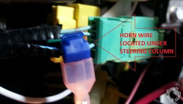

Horn:

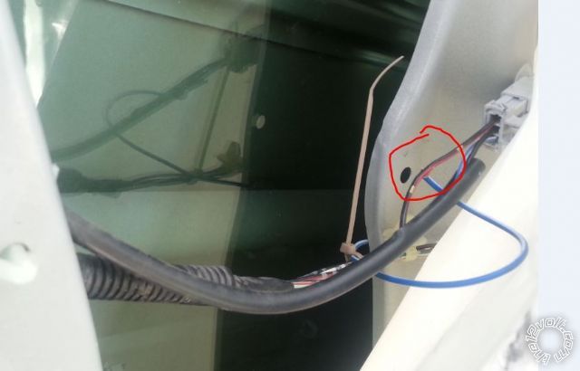

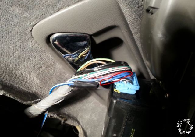

Even though, it's picture above, but make sure you test your wires before connecting them. I will post the disarm wire photo when I got my answer.
This is so frustrating....this piece doodie van give me so much problem. I also check on the passenger side of the kick panel and don't able to find the 2 pin plug, blue and orange.
