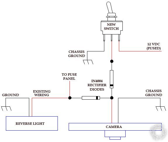

Posted: January 28, 2014 at 11:37 AM / IP Logged
Thanks for your response, oldspark.
Please see if my drawing represents a workable plan...
back up camera power from dual sources -- posted image.

Posted: January 28, 2014 at 4:53 PM / IP Logged
Yep - that looks good noting that only a lit switch requires the CHASSIS / GROUND connection, and the "TO FUSE PANEL" might mean 'from reverse switch' or switched Rev +12V etc.
