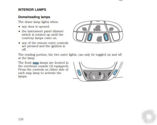

Posted: April 04, 2014 at 4:11 PM / IP Logged
they are working correct i think
here is an pic of your owners manual..
viper 5701 and dome lights problem -- posted image.

Posted: April 04, 2014 at 4:19 PM / IP Logged
JK on the previous post....
actually i think the maps are supposed to work ANYTIME like you are wanting.
i wonder if the fuse that feeds the maps is blown and when you activate the domes, power from the (turned on) domes' ground wire that is seeking ground goes through the map grounds when their switch is engaged and and through the map bulb finding ground in other devices connected to the maps power wire.
maps are kinda being reverse biased
anything else in your vehicle that requires constant 12v not working?
