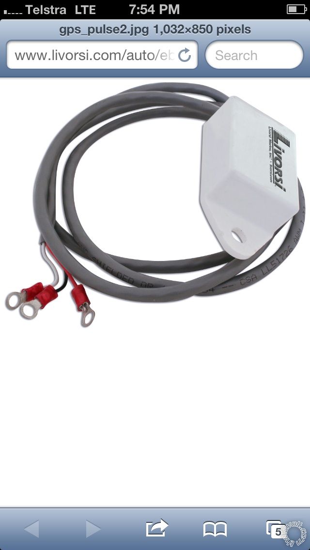

Has anyone fitted a GPS module/pulse antenna, to a oem electric speedo?
gps speedo conversion -- posted image.
Something like this marine one, a few other manufactures make them for the gauges like auto meter

Hi old spark, did you cut the speed signal wiring at the speedo and joined in the GPS signal wire?

No. I didn't do it.
Is yours an 8k or 16k speedo?

But as I understand that unit, you'd better find out before you buy.
And I presume you haven't understood how it connects if you are taking about cutting the speed signal wiring - unless I've read the wrong spec.

Yes, no cutting those three leads go to the speedo head, red = 12V+ ign., black = earth and grey = signal.
