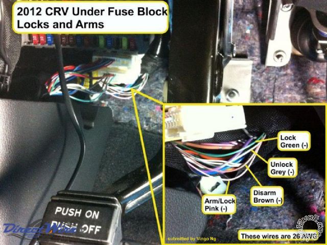

I will be installing the Scyteck 777C two-way alarm system in my wife's CRV and would like assistance with the following:
i) anyone know where i can find photos depicting wire locations for the alarm hookup.
ii) The crv has a wire where a single negative pulse will unlock the doors while the factory alarm disarm wire from the CRV requires a double negative pulse. The alarm comes with negative pulse wire for unlocking the door which can be programmed to do a double negative pulse. The alarm however does not come with either a factory alarm arm and disarm wires output. I got a tip to piggyback the alarm wire connection to the CRV door lock wire (a single negative pulse to) with a diode to the factory arm wire from the CRV. But i'm stuck on how to handle the double negative pulse that is needed to disarm the crv factory alarm. any help will be appreciated.

On the CRV the easiest way is to not use the unlock wire at all. Instead, use the key cylinder unlock wire(which is brown in the drivers door harness listed as disarm). Connect your alarms unlock wire here and set the alarm for double pulse. This will both disarm and unlock for you with no diodes needed.

You can do your idea with the two diodes, or Mike's idea with the double pulse.
(Note: Since you're installing only an alarm, this is not so complicated. If you were to install a remote starter, you'd also want to pulse the disarm wire before the remote starter starts the engine.)
Option 1: Split your alarm's unlock output with two diodes. The output from one diode goes to the brown disarm wire. The output from the other diode goes to the grey unlock wire.
Option 2: Without any diodes, connect your alarm's unlock output directly to the brown disarm wire, and program the alarm for double pulse unlock.
Both methods have advantages----#2 is easy and requires no extra parts, but there will be a slight delay while the alarm makes its second pulse. #1 requires slightly more work, but the system will immediately unlock all doors on the first pulse from the alarm.
PS: Are you just adding the alarm for the pager and shock sensor? Does your CRV already have a factory alarm? The base model (is it called the LX now?) doesn't have a factory alarm. The brown disarm wire will still be present in the car, but you don't need it----just go straight to the gray wire with a single pulse if you have no factory alarm.

KICK PANEL: Are you trying to hook up locks? I've never removed the kick panel on one of these cars before, and I don't think you need to.
Apply the foot-operated parking brake as hard as you can. Now look at the top edge of the kick panel. The wires you want are running just along the top edge of the panel, wrapped in this kind of black sleeving, and it's held on by being wrapped in black electrical tape in one spot.
Either unwrap or cut the electrical tape, and then you can pull away enough of the sleeving to see the wires.
After you've done this, I often find it easier to release the parking brake pedal at this point, and conduct your testing and splicing of the wires by reach behind the parking brake pedal.
