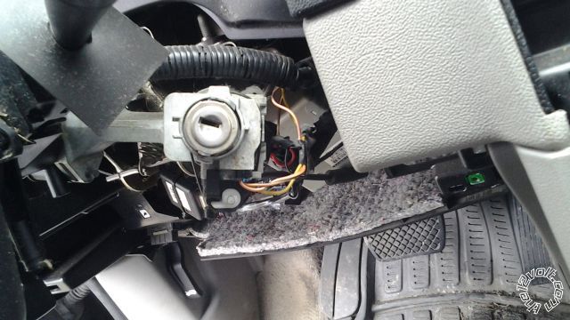

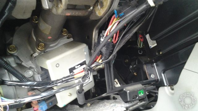

Hi where is the accessory wire? Sorry but dont even know where the ignition harness is. I have the dash off underneath stearing wheel.
My last wire I need toconnect lol.
I dont want to cut the wrong wire. Says brown is accessory 2. But where? Cant find any pictures online.
Thanks

Some pics if someone can help

Your second picture shows the ignition harness. It is the plug on the backside of the ignition switch. The connector is black and blue at top of picture. The brown wire is the accessory.
