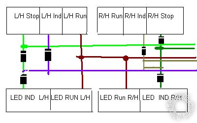

3 diodes per side, I just roughed this up for you:-

i tried that and it didn't work. i think i may have you confused so i made a mock up of the wiring i have.
if you can tell me where to put diodes that would help.
i am only using the brakelight input on the passenger side because the taillight converter itself only has one input wire.
when i hooked up the taillight converter first try with no diodes, everything worked except the issues were:
brakelight flashing with turn signals rapidly
brakelight flashing with hazard lights but at slow speed
when i put on the diodes like you have, it killed the turn signals completely on the LEDs as well as the brakelights.
