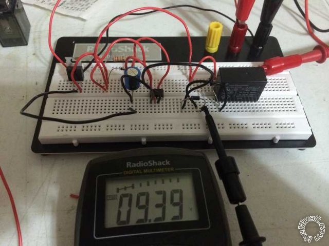

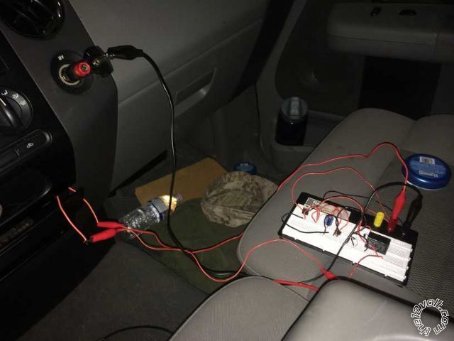

Well I didn't find the actually problem, but I did find a good fix. I wired up a 555 chip time delay circuit. It delays the power to 12 accessory by 5 seconds and works great.   And probably a good idea to wait tell the start start sequence is finished before powering on the stereo.
