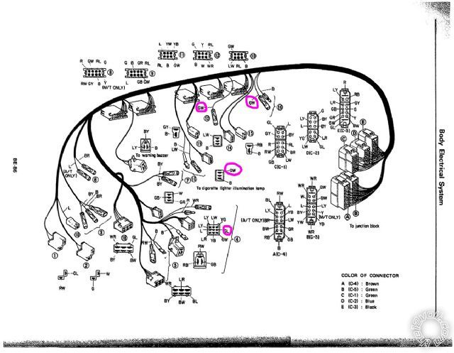

I try to install Viper 350v onto 1975 Datsun 280z.
Following instruction,
http://www.directeddealers.com/manuals/ig/viper/N426V_07-04.pdf
But I can't figure out which wire is "Parking Light"
'75 Datsun 280Z FSM - wiring.
http://www.atlanticz.ca/zclub/techtips/wiringdiagrams/75_280z_wiring.pdf
Does anyone know which wire I should hook up?

green / white

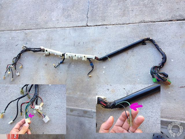

There are lot place I can connect GREEN / WHITE line.
Any recommendation for the best way to connect security system?

The right answer is near to power, ground and starter cuts a real world answer, well hidden with the wires taped over and stealthed.
