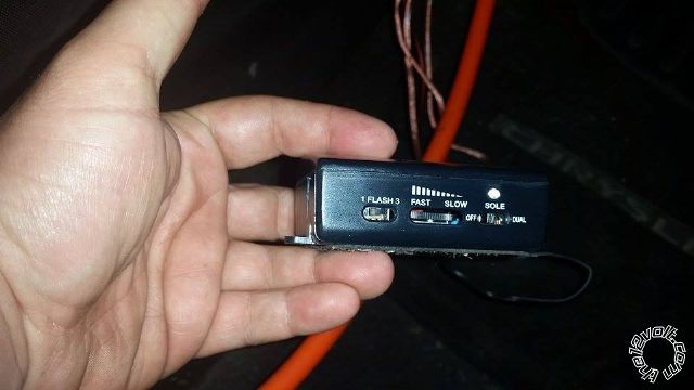

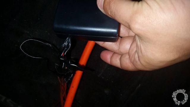

bklyn300
Joined: May 14, 2014
Posted: May 15, 2014 at 9:57 PM / IP Logged
turn signals -- posted image.
this is what i have.. a simple strobe box, in the back it has 4 sets of wires each set has a neg and pos wire to you can hook up four nights
oldspark
Gold - Posts: 4,913
Joined: November 03, 2008
Posted: May 15, 2014 at 10:35 PM / IP Logged
So it's not a common GND? Then my previous may not work.
Some strobes work using multiplexed signals - their GND is a part of that signal.
If it were common GND, another way is to connect it via a diode and insert a diode in the OEM flasher wire to the LED. That'll mean that the flasher will flash it on, but when not flashed on, the strobe will be lighting the LED.
You have to specify how the strobe works and is wired to its LEDs.
