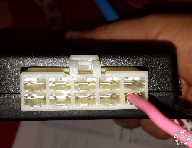

The reason I am asking those questions is because I tried to eliminate the unnecessary wires but from my mistake I removed all pins and I didnt marked the Connector.
My actual Connector is looking like this:
5704v to dball2 d2d and no remote start - Page 2 -- posted image.
Here I attached a scheme of the Connector. I hope is good.
