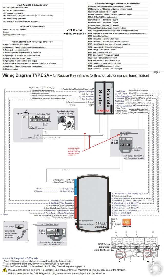

I have an automatic VW Passat B6 2010 model, and I want to install a security car sistem with remote start with DBALL2.
I have following modules:
-Viper 5704
-Directed 556U-B / 556UW for transponder key
-XpressKit XpressKit DBALL2 for CAN comunicatin
-Directed Directed 620V led flash
-Directed Directed 507M till sensor
-Directed Directed 506T audio sensor
I connected Viper 5704 to DBALL2 via W2W see diagram, but I have issues with connecting the Remote Start wires...could you help me with these?
passat b6 with viper5704 and dball2 -- posted image.

now I have done W2W..how I can change to D2D..just unplug the conectors?
plesea, could you help me with H3 connection harness?
here is what I think, but correct me if I missed someting.
remote start 10 pin heavy gauge connector
H3/1 pink (+) ignition 1 input/output     pin 11 black of G plug @BCM and pin 9 of 10 pin connector on dball2
H3/2 RED / white (+) fused 30a ignition 2/ flex replay input 87      pin 16 green of starter ignition harness
H3/3 orange (+) accessory output      12V constant
H3/4 violet (+) starter output car side of started kill      cut 3 GREEN/ red starter wire at ignition harness & connected H3/4 to starter side
H3/5 green (+) started input key side of starter kill      cut 3 GREEN/ red wire at ignition harness and connected H3/5 to key side
H3/6 red (+) fused 30a ignition 1 input
H3/7 pink/white (+) ignition 2 flex relay output
H3/8 pink/black (+) flex relay input 87a key side if required of flex relay      not used
H3/9 RED / black (+) fused 30a accessory/starter input      connected to same wire at ignition harness as I connected H3/2(RED / white)
Ovidiu
Posted: May 27, 2014 at 12:40 PM / IP Logged
It looks like all your H3 wires are wrong, I'll get back to you later.
Posted: May 27, 2014 at 3:52 PM / IP Logged
H3/1 Pink Correct.
H3/2 RED / white not used.
H3/3 Orange not used.
H3/4 Violet to starter side after cutting RED / black starter wire.
H3/5 Green to plug side of RED / black starter wire.
H3/6 Red to thick plain red at fusebox, side of instrument panel.
H3/7 Pink/white not used.
H3/8 Pink/black not used.
H3/9 RED / black join to red above.
Now read page 4 of the install guide.

I've read...and I connect:
pin 2 blue from bypass module to: -H2/5 dark blue (-) 200mA Status Output (Viper 5704)
    -pin 10 blue/white (-) GWR (status) input (DBALL2)
isn't corect?
Ovidiu
Posted: May 27, 2014 at 4:27 PM / IP Logged
Yes, exactly as you said.

my DBALL2 module is unprog. and i don't have XLoader2, is it posible to program is without XKLoade2?
regarding interconnection, I'll use W2W, and I have one wire which I dont no where I can connect it to alarm system (pin 8 (+) Start Input from black connector -- DBALL2)...
If I connect cable for D2D...module switch automaticaly to D2D, or I need to unplug conector?
thank you again
Ovidiu
Posted: May 27, 2014 at 4:39 PM / IP Logged
No.
And I fail to understand the second part of your question, just follow the diagram.
ovix
Member - Posts: 27
Joined: May 14, 2014
Location: Romania
Posted: May 27, 2014 at 4:47 PM / IP Logged
in D2D mode it has more functions...and if I want to shich from W2W to D2D...how I can do this? when I connect cable whit 4 pins...module knows and shich automaticaly...to D2D? or it is necessary to unplug conectors from alarm system?! I hope to understand now (my English is not so good...:))
regarding sensors...how it is better to pair them first connector(shock sensor + till sensor) and the second connector (audio sensor)...isn't correct?
Ovidiu
