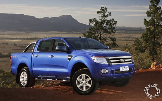

Somebody knows where I can find the Tachsignal on a 2012 Ford Ranger Diesel 3.2L XLT. This Versión of the Ford Ranger is a clone versión of the Mazda BT-50.
Here is an Image:
ford ranger diesel 3.2l xlt -- posted image.
Maybe somebody knows where I can find the Can HIGH/Can Low signal on this Truck to try to use a Fortin EVO-ALL just for Canbus use and get that way the Tach signal.
Thanks in advance for any reply.

Last Rangers here in the States were 2011's.  The CAN wires on your 2012 can be found at the BCM, Green C1 Plug.
CAN High = Pin 41    Gray/Orange
CAN Low  = Pin 40    Violet/Orange
You might try using the XPressKit Europe WEB site as they list the Ford Ranger thru 2014 and it might even include the
diesel version, too.   First go to the XPressKit site at :  http://www.xpresskit.com/default.aspx     In the upper right-hand
area you will see a U.S. flag.  Click on the flag and then select Europe and then save it.  Next look up your Ranger.
They list a DB-ALL & firmware.   Here is a link to the 2012 Ranger install guide :
http://www.xpresskit.com/DocumentDownload.aspx?documentid=9131&productid=461&firmwareid=3904
