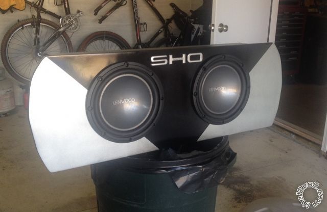

What makes it complicated is, I have some LED lights on the box that I need to turn on, too. One string of lights is wrapped around the box and I want them on when the amp is on; another string is around the sides and I'd like those to pulse with the base.
For the pulsing light, I think I just use the speaker output to run those (though I'm not sure if that causes issues). For the other one, can I use the signal processor to turn them off and on or will I need something separate? Thanks.

Something I did myself. See the picture. The front of the box has a lip all the way around it, I have a blue LED ribbon wrapped around it - this light would be on with the amp. Then, on each side, I want to install a short strip of LED's that would pulse with the base (if not too difficult to do). proper way to wire amp, led’s? -- posted image.

Powering LEDs on with the amp is easy. Just use a relay triggered from the amp turn-on signal. Pulsing LEDs with the music is more difficult, but there are controllers you can buy that do that. Here's One.
