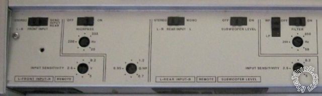

I do have a Clarion 7-band equalizer to control a little bit of frequencies. Like the last guy suggested, maybe it's the amp's output on the right rear channel. I'm just not familiar with the internal workings of amps. Oh sure, I know what mosfets are and all, I just don't know enough about circuit boards and testing amps to figure out if an output is bad. Is there a way an electronics repair shop could test an output for me? What would they look for?
These are the controls on my amp. This is NOT a picture of how I have anything set, it's just a picture I saved from a google image search before I bought it. Oh, and I got it on ebay. That might be my problem right there! LOL!
is something blowing my speaker? -- posted image.

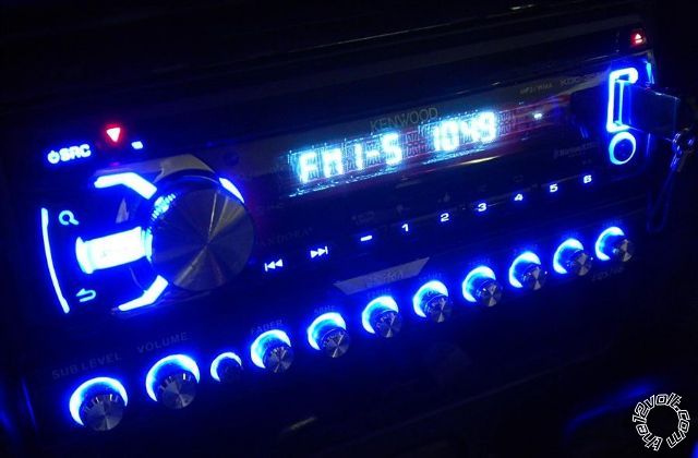

My head unit and equalizer in daylight:
Cool blue lights at night!
