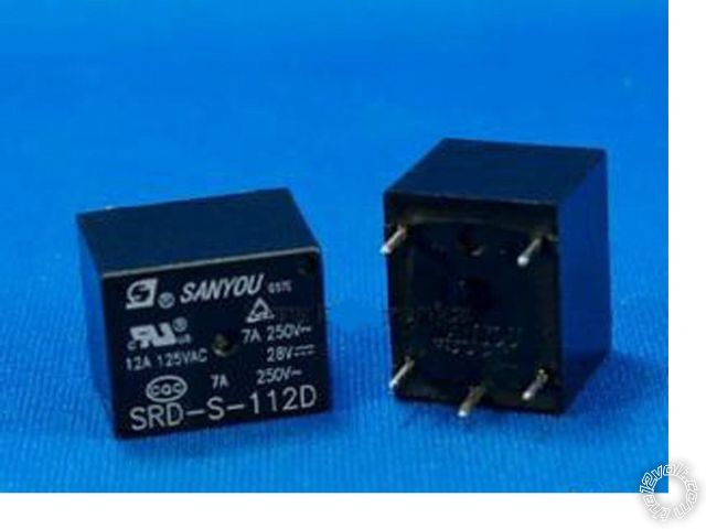

Perhaps a relay issue?  Extra resistance between the Pin 30 to 87 contacts?  Flaky relay?  Might try a new relay.  I use a mini 10A relay with wires soldered right on to the pins for those VATS / Passlock systems.

Blimey Kreg are you going to the same place 3000 miles apart to buy our PC relays?
Platinum - Posts: 7,827
Posted: August 09, 2014 at 12:19 PM / IP Logged
Very possible, Howard.  Get them in quantities of 50 for $0.49 each....  vats bypass trouble 96 caddy deville -- posted image.  Compact, completely sealed and very reliable.  Just a bit of work soldering the wires to the legs.
Posted: August 09, 2014 at 12:21 PM / IP Logged
Not forgetting diodes vats bypass trouble 96 caddy deville -- posted image.
