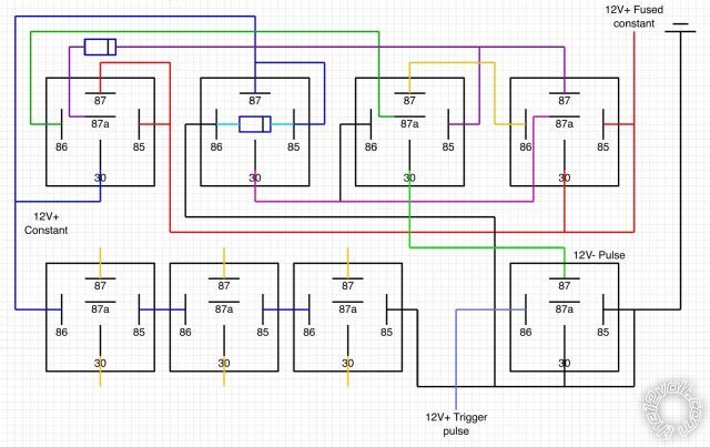

Will the following work?
It's based upon the available schematics.
momentary to constant multiple con -- posted image.

The coils of the three relays you've added to the 12V+ output from the pulsed on/off setup need to be wired in parallel, not series, to work.
momentary to constant multiple con -- posted image. the12volt • Support the12volt.com

Posted: August 18, 2014 at 1:07 AM / IP Logged
Oké thanks!
In a Dutch forum they are complaining that this has too many relays and will not work.
But they don't have any nice diagrams that are tested

Posted: October 12, 2014 at 11:37 AM / IP Logged
I have the relays and the switch.
Today I managed to get everything to work except for one thing.
The pulse is too long so it immediately switches the circuit back on.
Is there a way to use the following diagram with an extra relay to switch the circuit off?

Posted: October 13, 2014 at 7:03 AM / IP Logged
Tested the diagram above and it's working perfect.
Need to add a switch or relay to brake the connection, but that won't be a problem.
