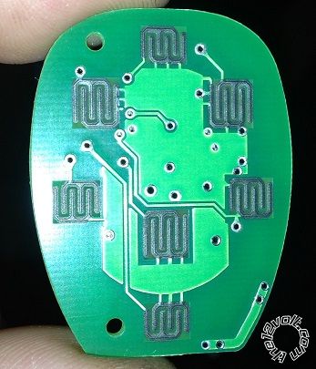

Ok I just had a ridiculous "think outside the box" idea, I wonder if I could add an aftermarket alarm, and hardwire the remote start output to trigger an additional oem keyfob hidden in the car. I could solder into the button pad circuits on the keyfob, and the biggest challenge would be figuring out a way to momentarily close the lock button circuit, then close and hold the start button circuit for 4 seconds. If I could pull it off I could have an awesome 2 way paging alarm system that remote starts via the oem radio signal thus retaining all of the conveniences of the OEM remote start (automatic selection of proper climate control mode, rear defogger, and no radio blaring) and also have the 1 mile range and 2 way paging of an aftermarket alarm. The only aggravation would be periodically changing the hidden remote battery but I'm sure if I get that far I can easily drop the 12 volts to 3 volt and hardwire that part as well.

I am really thinking my crazy idea is achievable. The fob will be a piece of cake to solder wires onto, and I think I can setup a couple of time delay relays or even a small microprocessor to cover the button sequence/timing. I'll wire it up so the "Start" output of the remote start which normally spins the starter will simply activate my custom interface. I'll have to hookup the tach wire so the RS detects the engine has started, and also figure a way to make a remote shutdown happen through the oem fob. If anyone can think of a reason this is a bad idea or will not work please speak up, as I may have overlooked something in my excitement!     add alarm to 2012 impala lt -- posted image.
