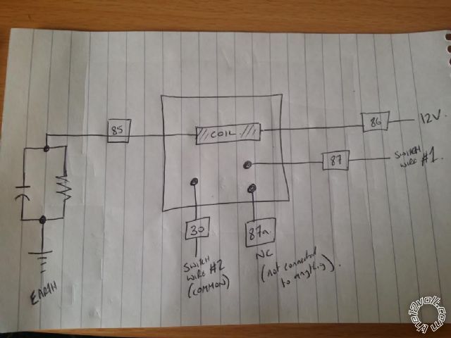

If I understand correctly, I need to create a circuit like this...?
laptop power on when ignition live -- posted image.
To be clear, when the 12V is live (i.e. ignition is on), using this circuit will momentarily connect the two wires of my switch together for a split second, then disconnect them again? If they were to remain connected longer, then this wouldn't work as it would have the effect of pushing and holding the power button. Which would shut the laptop down again.

That circuit is correct.
Like I said, I reckon you do not need the resistor. Its function is to discharge the capacitor when IGN (the +12V to 86) is turned off. But since IGN circuits almost always have other loads like other relays (solenoids) or instrumentation, they will discharge the cap thru its relay solenoid & the 10k resistor's effect will be negligible.
BTW, if that "discharge" resistor (parallel to the cap) is used, its resistance must be (say) at least 10x if not 20x the resistance of the relay coil/solenoid, otherwise the relay may "hold" on.
FYI - the circuit works because - despite caps NOT transferring or conducting DC - initially it is discharged with 0V across it.
When voltage is applied to a discharged cap, the cap looks like a short circuit so the relay coil gets its full voltage & current.
As the cap charges (thru the relay coil) its voltage increases and the coil voltage & current drops until it turns off.
Only if that parallel bleed/discharge resistor is low enough will enough current flow thru the coil to keep the relay closed/on. (Or if the cap short circuits...)
The coil's resistance R and the caps capacitance C form an RC delay circuit.
